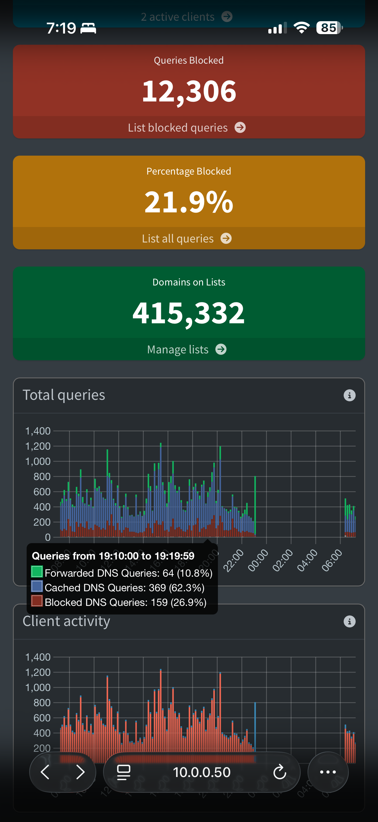

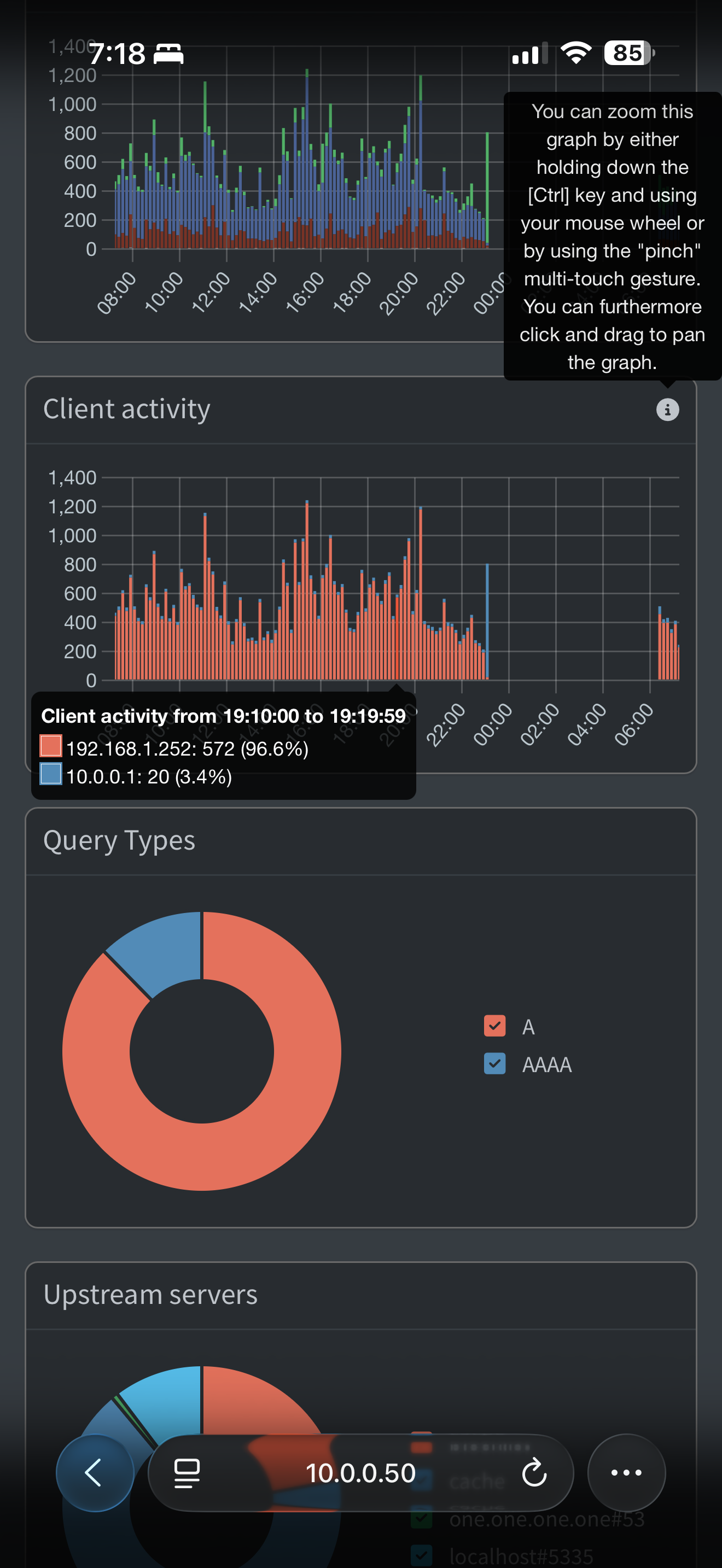

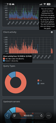

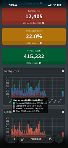

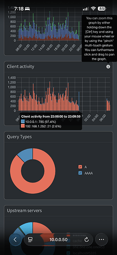

I’ve been having an issue with my pi-hole overnight. Just around 11:00 PM a ton of forwarded requests to my unbound service, much more than usual then no traffic until I woke up and rebooted both router and Pihole. I would expect it to continue running and my router & Pihole to be online overnight.

Spike at 11:00 PM and then losing all network on router and pi-hole

    Pi-hole was restarted again (probably by you???), around 6:30 am (the log shows Pi-hole running under a different PID):
    2026-02-01 06:34:51.933 PST [639M] INFO: PID of FTL process: 639
  1. apparently the network was not sending queries to Pi-hole between 23:10 and 6:20.
    Are you sure the router was on?
    If the router was turned off, the devices would not be able to send queries to Pi-hole, even if Pi-hole was running all the time.
I’m fairly certain the router was on.. I have it set to reboot at 2:00 AM, so unless it had trouble telling time (or is set for eastern instead of pacific..) when I woke up it was on but had an issue saying there was no internet. I’m going to not have it restart tonight and see if that changes anything.
