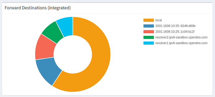

I don't understand the "persistent referral to the blocking address" issue. This will always happen regardless if you use either the package or the compiled version. I'm running Pi-hole with the cache size unlimited by the code (and manually configured to 500,000) since more than a year without having encountered any problems at all.
As you can see, my cache utilization is about ~60% but I wouldn't expect a higher value due to two reasons:
  • I'm a rather conservative user, i.e. I go somewhere, do something and that's it. I don't browse around or stay a long time on the same webpage for which caching yould be favorable
  • I use only browsers with inbuilt DNS caching (Vivaldi), i.e. there is an intrinsic reduction of DNS queries that is sent out at all. If you are using browsers that aren't caching the requests, the percentage can easily be higher than 95%, I guess...
